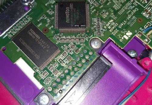

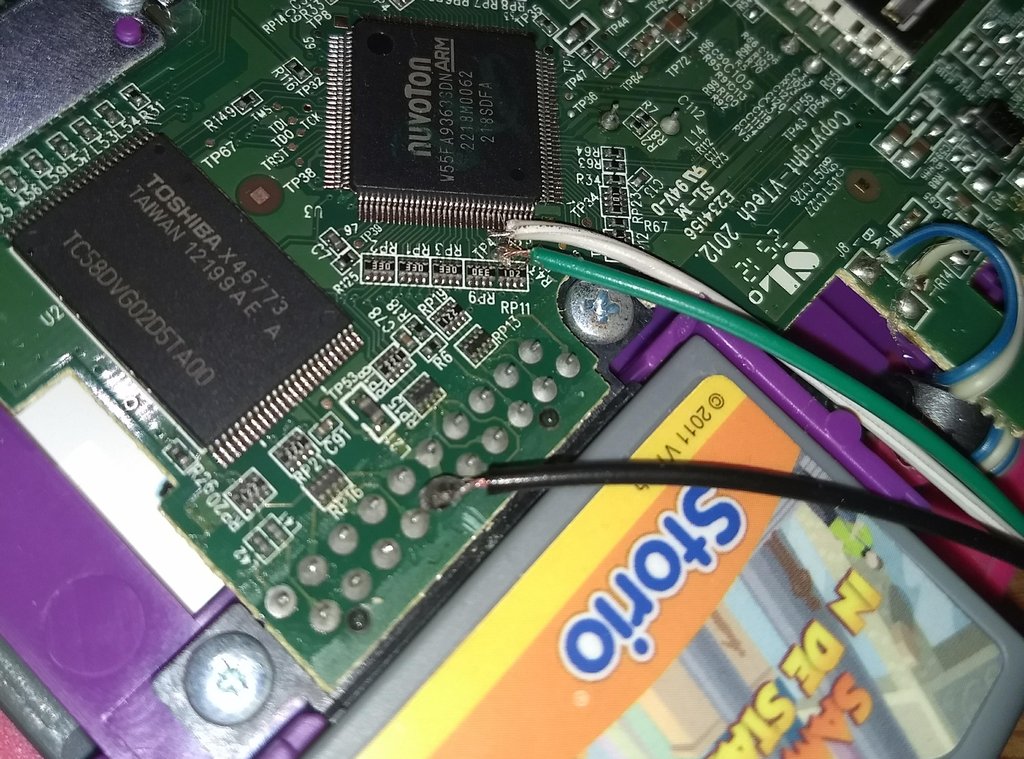

I have finally figured out the testpads for the UART of the ARM chip inside the Innotab 1 : they are TP4 for TXD and TP3 for RXD
i couldnt figure out a GND (ground) pad so i have opted for one of GND pins of the cart port ( as the pins of the cartridge port are
similar of Innotab 2+).
The testpads are really small so it isn't easy to solder leads to a USB - TTL Serial Cable .
But finally i could read some bootlog messages:
The detected NAND chip-ID matches closely to the Toshiba NAND flash chip according to this NAND Flash table
Code:
