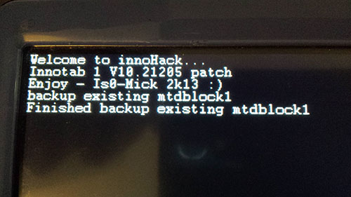

just joined the community and had a go at running the innotab 1 firmware patch. Used a good SD card and followed all the instructions in the FAQ. When i click execute the file runs and then seems to pause halfway through the last line is "finished backup existing mtdblock1" then it just hangs there and doesn't reset or anything. What should I do next?

(01-24-2016, 02:53 AM)JCollins Wrote: this is the image if it helps

In absolutely the same boat. Any one got any ideas?

After some wonderful help from Mick, the link below has the my_run file you need. Replace the one in the original download with the one from this link..
Alex
http://www101.zippyshare.com/v/56KepUTR/file.html
thanks Alex that's really helpful - didn't think I would ever get a reply! that seemed to work - well it completed this time and rebooted etc - angry birds loads does that mean it worked? would appreciate hearing how you got on Alex? cheers
