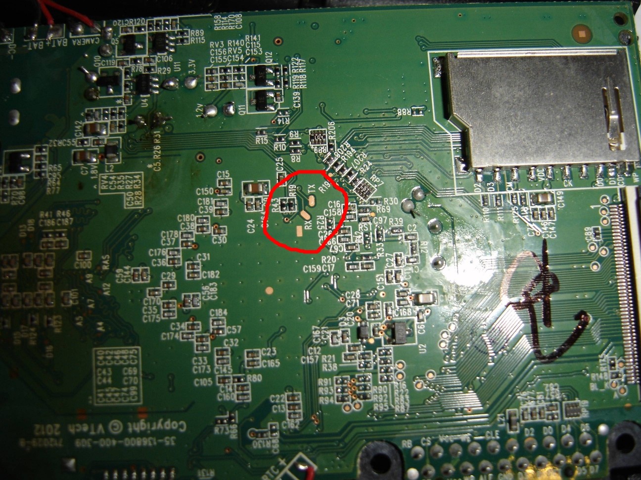

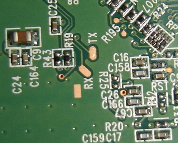

		Hi!

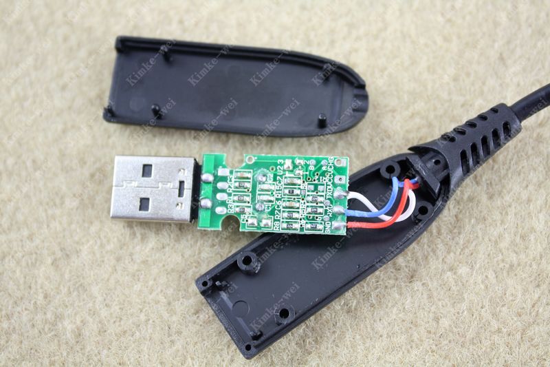

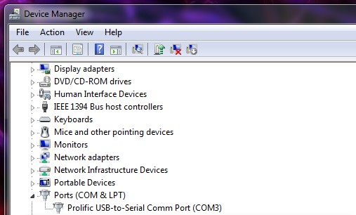

I successfully soldering my bricked device and connected it with this adapter ( http://www.amazon.de/gp/product/B00AFRXKFU). I do all steps from this tutorial but at the point "You now must kill the fastboot" it will show this:
 http://postimg.org/image/f1oa6brcf/
Is this correct or what should "app_destoyer.x -f" must show?
Thanks!

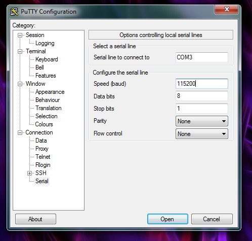

How can i make a txt-file with the bootup output? The putty window not show all.

		I think you can right click on save the output to a file or select all or something like that.  It might also automatically save to a log file that gets overwritten after each putty load.  You could check for that log file in the same folder as putty.

		Sorry, find putty logging configuration...
