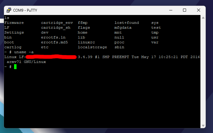

XI. Verifying you did it right
First of all, if your LeapPad is stuck on the LF logo and constantly is printing something out over UART, you did something wrong. Double check the "inittab" file. If you still get the prompt asking you for a password, again, double check "inittab". However, if, you can successfully connect, you're finished.
