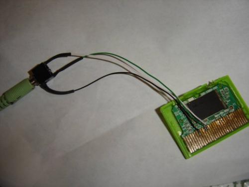

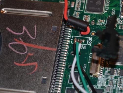

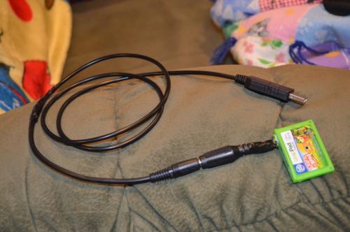

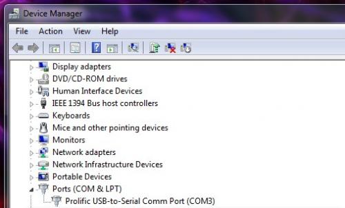

Install the drivers for your converter cable.
Open the device and solder to the points shown or modify a game cart and solder some wires on to the points shown. This way you can simply plug in the cartridge and not have to open the device.
Check out this URL for more info http://elinux.org/LeapFrog_Pollux_Platfo...Connection
