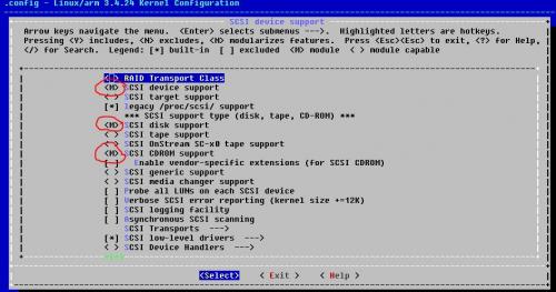

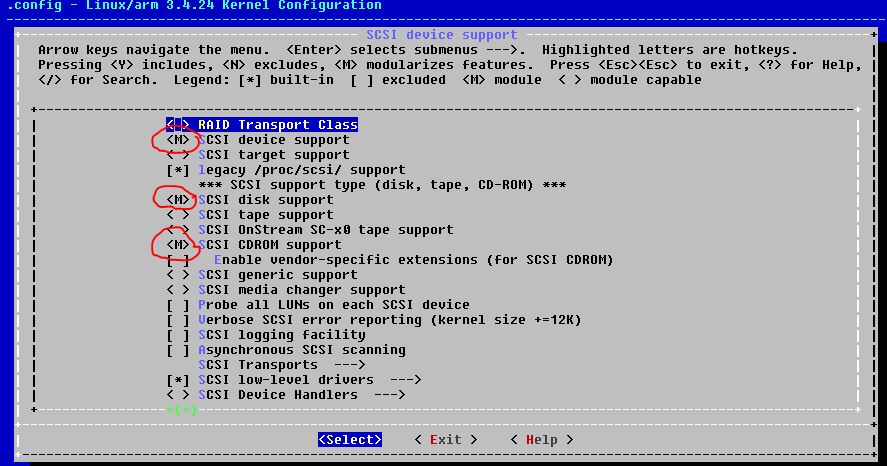

bu so far I have mixed results. The framebuffer modules build fine and can be 'insmod'-ed correctly  but usb storage and hid are missing other modules which current kernel source does not build for me.
For usb storage I need scsi support, so even if I enable both as a modules it only builds scsi cdrom.ko module for me Sad
[attachment=181]
No scsi and scsi disk kernel modules get build. And when also enabling usb storage I see error when building it

So it looks like for some reason the scsi code is not built and then it fails.

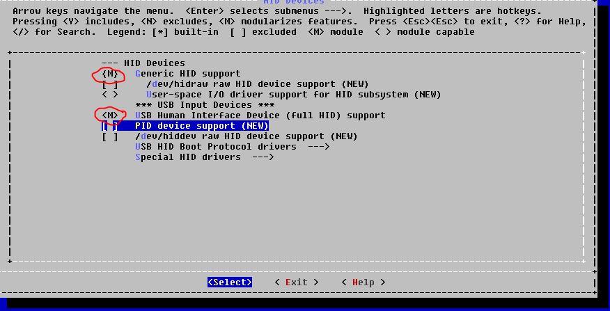

And similar for usb keyboard mouse, it does not build generic HID support. This time at least modules build fine but usbhid.ko cannot be inserted because it misses symbols from generic hid modules (hid.ko, hid_generic.ko) which do _not_ get built even if enabled in config as modules.
[attachment=182]
I guess it can be related to usb gadget storage modules being enabled and conflicting with the host mode drivers in some way but this should work in general. Maybe leapfrog/nxp engineers broke something in the kernel dependencies when adding their drivers.
I'll continue with this and let you know when I get it working. If someone finds the reason why it does not build those (scsi, generic hid) modules then let me know too.

And btw when looking in the .config file I really see
# SCSI device support
CONFIG_SCSI_MOD=m
CONFIG_SCSI=m
CONFIG_BLK_DEV_SD=m
CONFIG_HID_SUPPORT=y
CONFIG_HID=m
# CONFIG_HIDRAW is not set
# CONFIG_UHID is not set
CONFIG_USB_HID=m
and yet it does not build it
