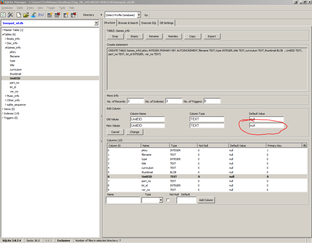

4a. If you have an Innotab 2s or 3s, you will need to get the UnitEID you found earlier, open the Innopad_wf.db file with an SQL Manager software, browse to the Games table and edit the UnitEID field for the flasher app to your UnitEID value. Then save the database and proceed

Hi I don't wish to sound an idiot I can normally do anything on computers and I had no problems with innotab 2 & 3 but I can't seem to flash the 3s Ive tried many times and that database editor doesn't give me the option to edit the united am I missing something
Thanks
You have to make sure to edit the correct database. The 3s uses the innopad_wf.db or something like that so you must make sure that you edit that database.
(12-23-2014, 10:49 AM)Deak Phreak Wrote: You have to make sure to edit the correct database.  The 3s uses the innopad_wf.db or something like that so you must make sure that you edit that database.
I seriously can't work it out its really bugging me
I seriously can't work it out its really bugging me it's just not making sense to me
